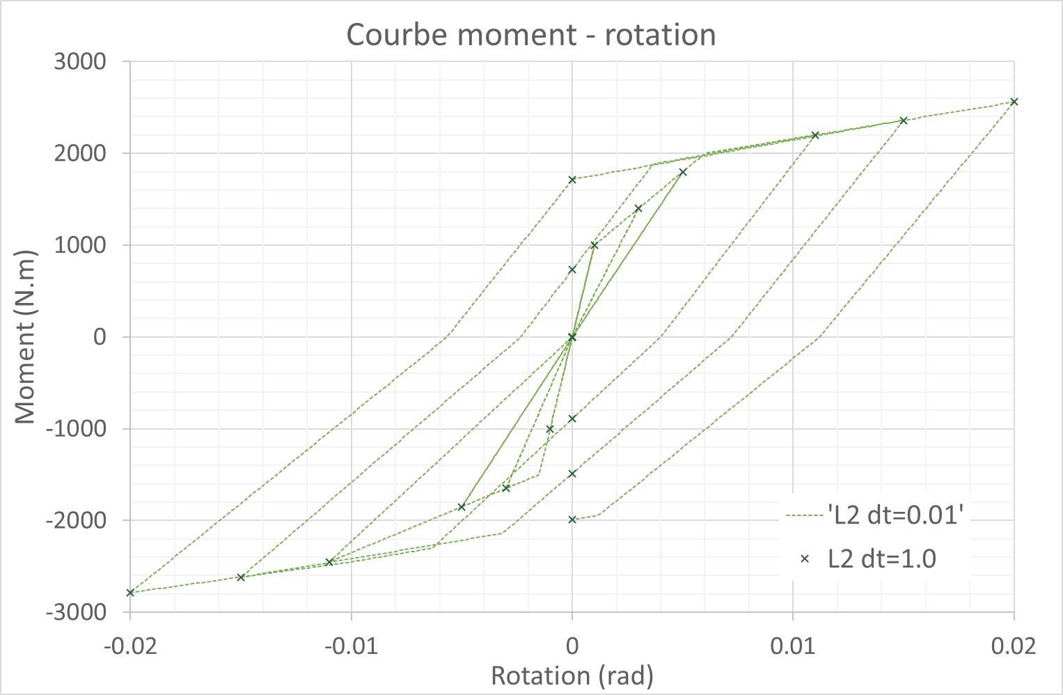

../../../../_images/10000201000005F7000003E6629FC035A4B46810.png
Figure 2.2-a : Courbe Moment-rotation, élément 1.
La réponse donnée par Code_Aster est testée pour les valeurs suivantes:
Tableau 2.2-a : rotationset moments, élément 1.
Instant
rotation \({\theta}_{z}\)
Moment \({M}_{z}\)
1.0000000000E+00
1.0000000000E+03
1.0000000000E-03
3.0000000000E+00
-1.0000000000E+03
-1.0000000000E-03
5.0000000000E+00
1.4000156777E+03
3.0000000000E-03
7.0000000000E+00
-1.6500032505E+03
-3.0000000000E-03
9.0000000000E+00
1.8000256320E+03
5.0000000000E-03
1.1000000000E+01
-1.8500108811E+03
-5.0000000000E-03
1.3000000000E+01
2.2000192257E+03
1.1000000000E-02
1.5000000000E+01
-2.4833453804E+03
-1.1000000000E-02
1.7000000000E+01
2.3601391920E+03
1.5000000000E-02
1.9000000000E+01
-2.6166696872E+03
-1.5000000000E-02
2.1000000000E+01
2.5600393177E+03
2.0000000000E-02
2.3000000000E+01
-2.7833327927E+03
-2.0000000000E-02

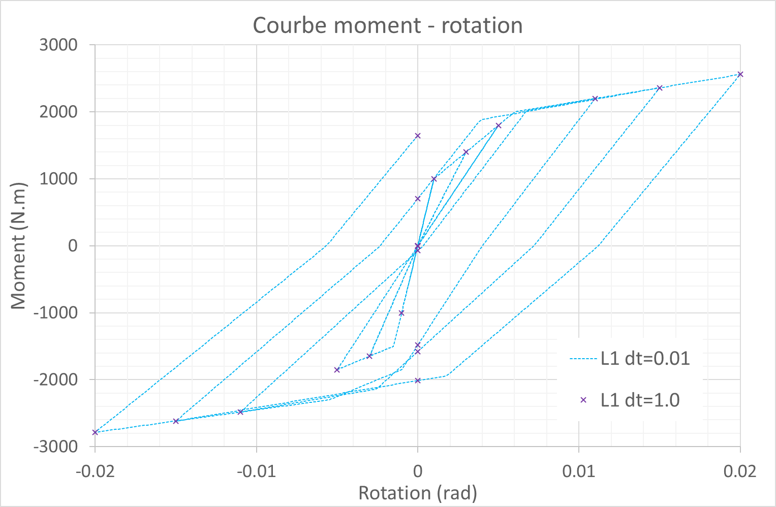

../../../../_images/10000201000005F7000003E61295576838939B58.png
Figure 2.2-b : Courbe Moment-rotation, élément 2.
Tableau 2.2-b : rotationset moments, élément 2.
Instant
Moment \({M}_{z}\)
1.0000000000E+00
-1.0000000000E+03
-1.0000000000E-03
3.0000000000E+00
1.0000000000E+03
1.0000000000E-03
5.0000000000E+00
-1.6500000701E+03
-3.0000000000E-03
7.0000000000E+00
1.4000143913E+03
3.0000000000E-03
9.0000000000E+00
-1.8500245881E+03
-5.0000000000E-03
1.1000000000E+01
1.8000013063E+03
5.0000000000E-03
1.3000000000E+01
-2.4500169230E+03
-1.1000000000E-02
1.5000000000E+01
2.2000156060E+03
1.1000000000E-02
1.7000000000E+01
-2.6166668190E+03
-1.5000000000E-02
1.9000000000E+01
2.3601185361E+03
1.5000000000E-02
2.1000000000E+01
-2.7833347518E+03
-2.0000000000E-02
2.3000000000E+01
2.5600383030E+03
2.0000000000E-02

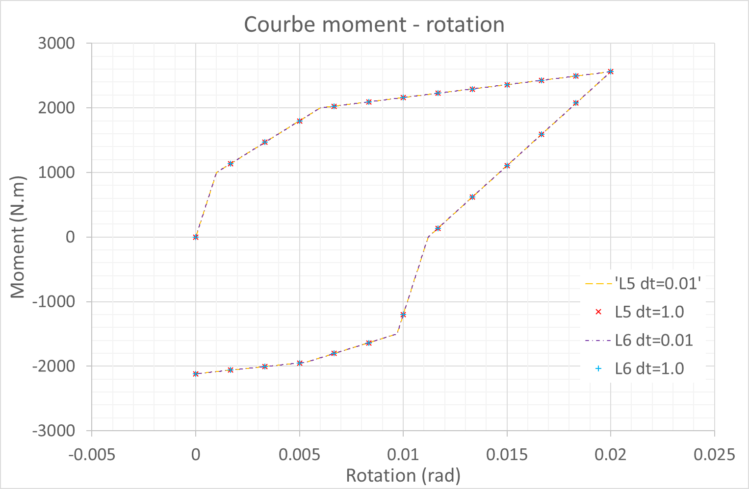

../../../../_images/10000201000005F7000003E6E477314F4FEE71E9.png
Figure 2.2-c : Courbe Moment-rotation, éléments5 et 6.
Tableau 2.2-c : rotationset moments, éléments5 et 6.
Instant
Moment \({M}_{z}\)
3.0000000000E+00
1.8000004556E+03
5.0000000000E-03
6.0000000000E+00
2.1600162134E+03
1.0000000000E-02
9.0000000000E+00
2.3600225066E+03
1.5000000000E-02
1.2000000000E+01
2.5599993245E+03
2.0000000000E-02
1.5000000000E+01
1.1054534813E+03
1.5000000000E-02
1.8000000000E+01
-1.2000046711E+03
1.0000000000E-02
2.1000000000E+01
-1.9499993974E+03
5.0000000000E-03
